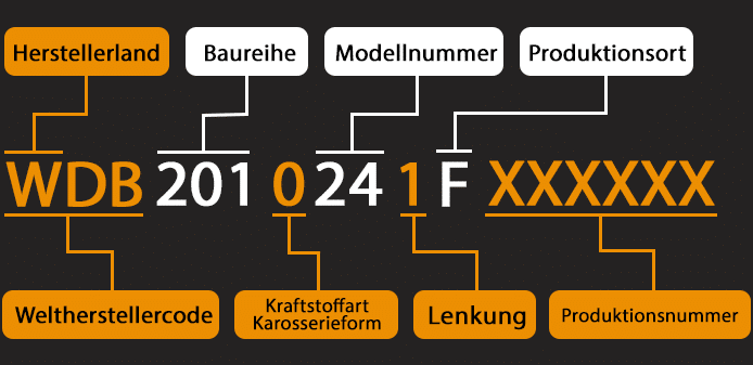

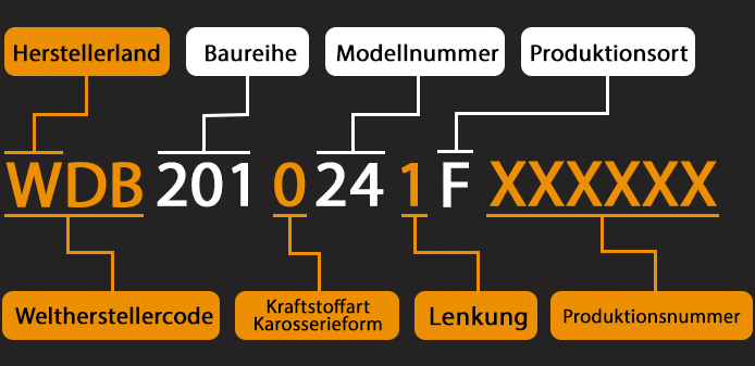

    Example of a Mercedes-Benz Chassis Number
    Below, we’ll break down the chassis number of my scrapped Mercedes 190 2.0L, encoded according to the 1983–1985 schema:
    • WDB: World Manufacturer Identifier for Germany (W) and Daimler-Benz (DB).
    • 201: Model series W201, our 190 model.
    • 0: Indicates a petrol engine.
    • 24: Model number, 2.0L sedan.
    • 1: Left-hand drive vehicle.
    • F: Production plant, in this case, Bremen.
    • XXXXXX: The six-digit sequential production or build number.
    Explanation
    Now we can decode the chassis number from the example above. But what do the other codes mean? Below are some hints about other chassis numbers and their 17-character codes:
    1-3 / 4-6 / 7 / 8-9 / 10 / 11 / 12-17
    1-3 WDB:
    The three-character code WDB is the World Manufacturer Identifier (WMI), consisting of the country and manufacturer. W stands for Germany, and DB for Daimler-Benz. Later, this code was changed or expanded; see modifications below.
    4-6 Series:
    These three digits indicate the model series, e.g., 201, 202, 124, 210, 126, 140, etc.
    7 Fuel Type or Body Variant:
    Initially, this digit encoded the fuel type: 0 for petrol and 1 for diesel. Later, it was used for the body variant:
    • 0: Sedan
    • 1: Long-wheelbase sedan
    • 2: Station wagon (T-Model, also B-Class)
    • 3: Coupe
    • 4: Convertible/Roadster
    • 6: Chassis for special uses, e.g., hearses/ambulances
    • 8: Pullman/Stretch limousine
    8-9 Model Number:
    A two-digit number encodes the model. For example:
    • 24: My 2.0L 190E.
    • 44: My 500 SEC.
    10 Left-/Right-Hand Drive:
    • 1: Left-hand drive.
    • 2: Right-hand drive.
    11 Production Location:
    A single letter indicates the production plant:
    • A: Sindelfingen (or Tuscaloosa, USA, if VIN starts with WDC or W1N)
    • B, C: Sindelfingen
    • F, G: Bremen
    • J: Rastatt
    • N: Hungary
    • R: South Africa
    • T: Karmann
    • W: Mexico
    • X: Graz
    12-17 Serial Number:
    A six-digit sequential serial number.
